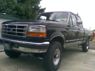

Well I'm a new poster but a long time lurker. I just rolled over 200,000 miles on my 97 F250.
Every year I get laid off for a couple of months starting in a few weeks. This year I have access to a garage! So I am trying to come up with a list of what to check/upgrade on my truck.
The truck: 1997 F250 4x4 7.3 5 speed Extended Cab Short Box. Upgrades: 6637 intake, 3"dp, aftermarket exhaust, stereo, speakers, and driving lights. 255/85r16 Dean MT tires. Everything else is stock.
