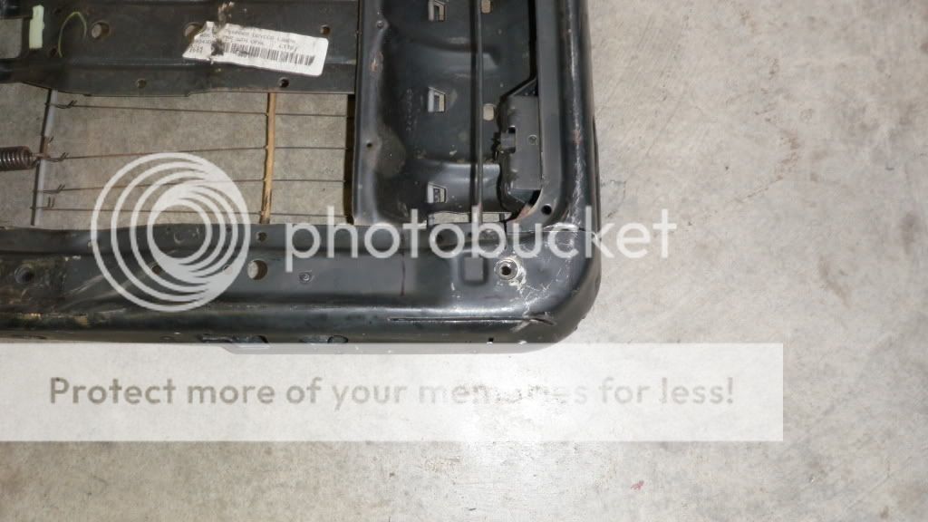

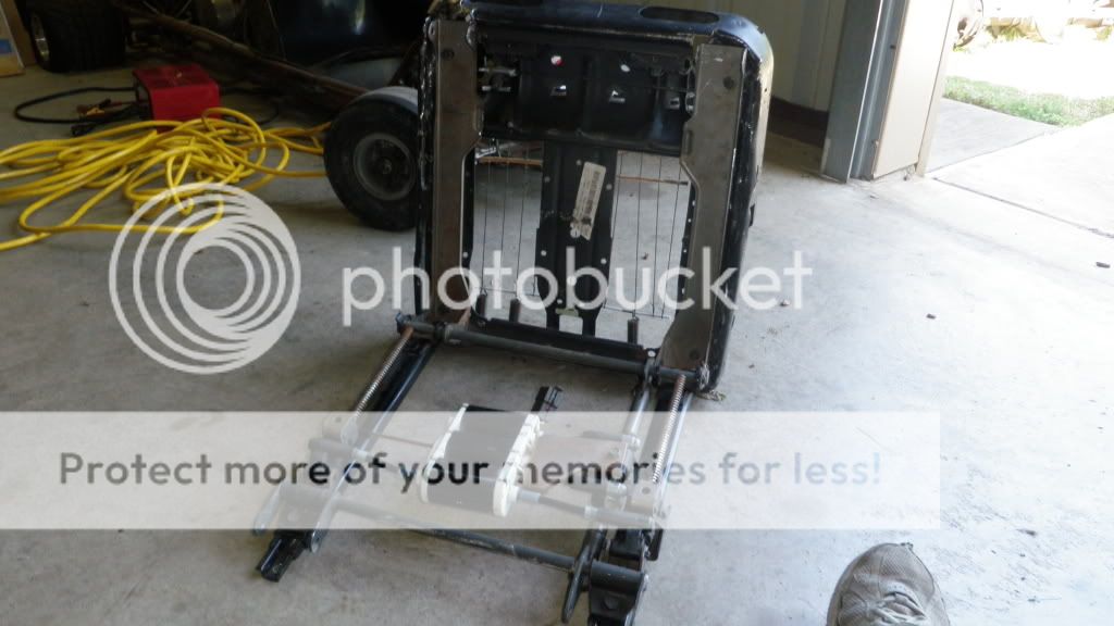

The day after I picked them up I put a little work into the seats. I checked to see if they were working as they should. I got the drivers side seat completely pulled apart
After that I had a better idea of what I wanted to do. Mounting them in their existing form wouldnt be hard but I couldn't go that route. I plan on cutting down on height in a couple of ways so I can make my goal of adding no less than an inch to the height of the seat

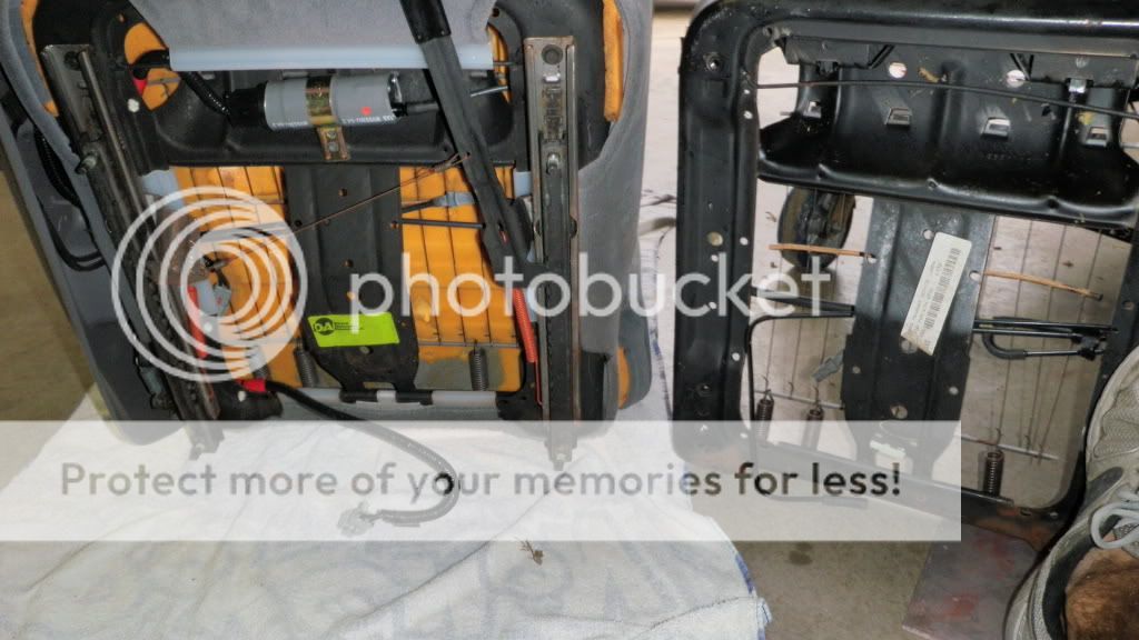

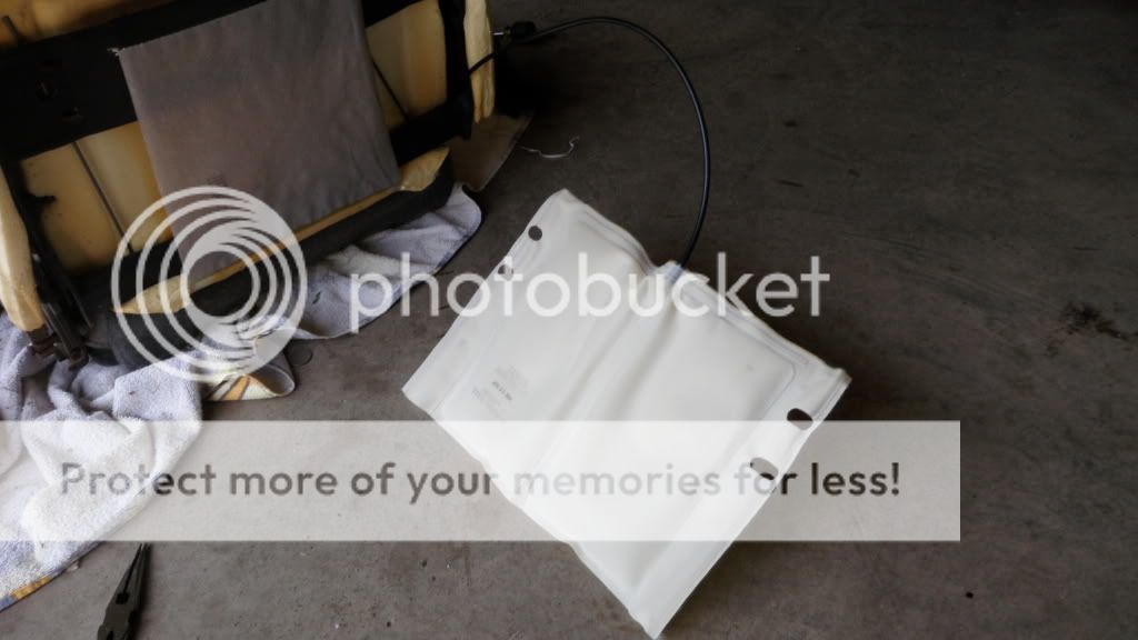

I stripped the seats down to the bone taking everything i thought I could use including the lumbar bags which i now have installed in my rear bench seat.

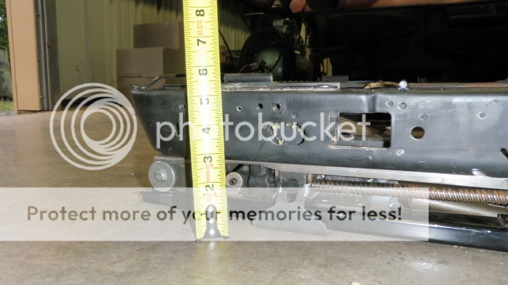

This is the seat slider nearly at the bottom of its adjustment.
I planned on cutting height by making the seat tracks sit closer to the mounting plate for the seat cushion.

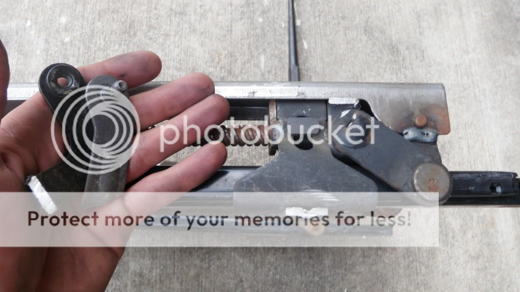

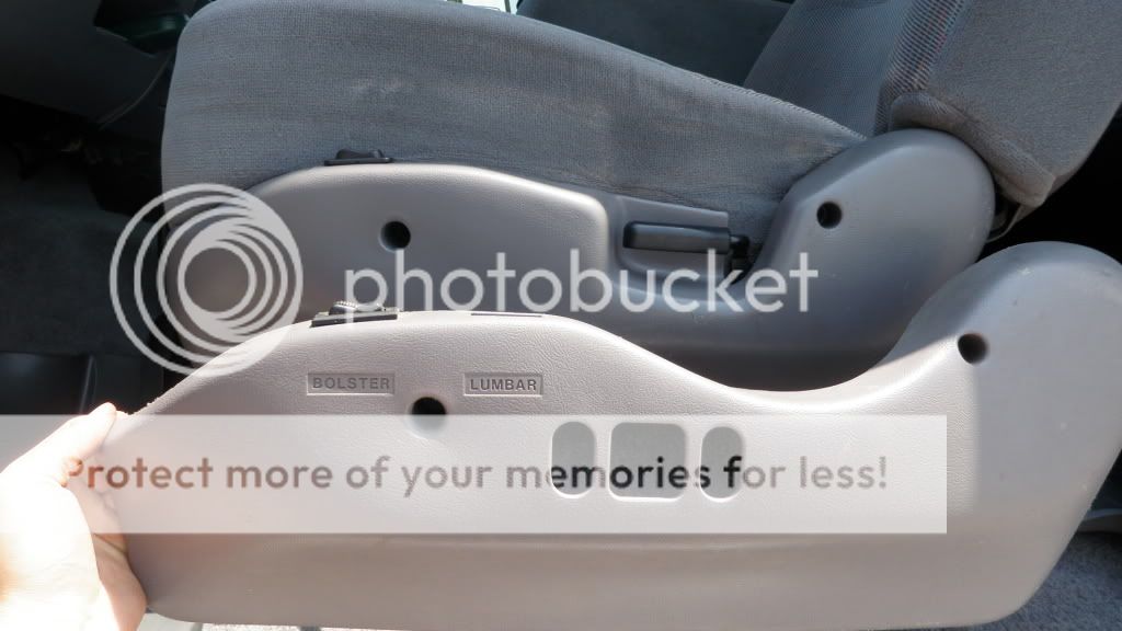

Also here's a comparison of the two plastic pieces the stock handles wont work, so the explorer handle/hinge/spring assembly will go on as well since they are completely interchangeable.

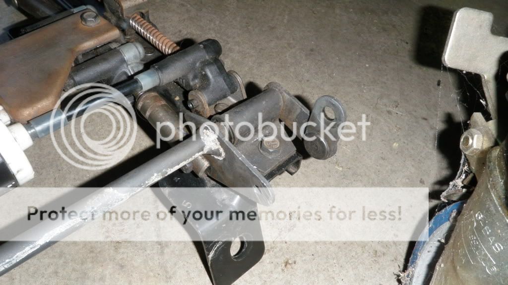

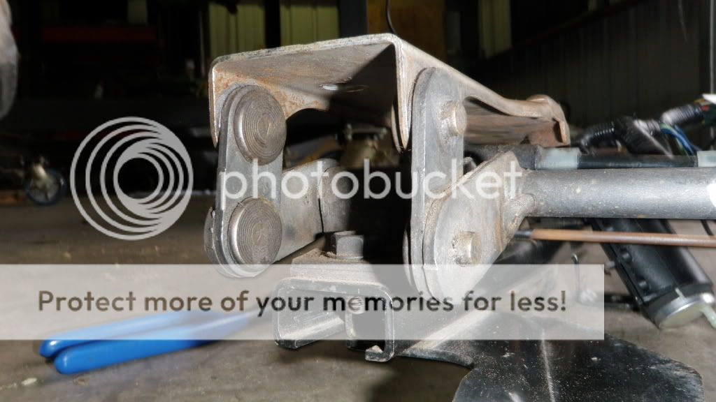

I will be loosing a 1/2" in height and the unnecessary tilt on the sliders. The sliders will now be flat on top like the manual ones. Since the tilt is built into the seat, seat tray, and the power sliders have a tilt control function, so it only made since to try to get the seat lower and resting at a good angle.

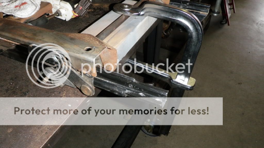

I cut off the heads of the rivets and punched them out allowing me to get rid of the middle piece and bolt the top rail of the tracks directly to rail that controls the front tilt.
Heres what the modified drivers tracks looks like next to the unmodified passenger tracks. I enlarged the hole on top rail of the track and used a bolt with some large washers and locknuts in place of the old hinge. I only have on bolt on each side but it has proven to be plent strong. I would have used two bolts but the other side doesnt line up quite that well.
After analyzing them closely I realized that the front tilt is not double hinging. Only the top rivets hinged, explaining the washers and grease between them, and no washers or grease on the bottom. So I saved alot of height by cutting out the middle piece.

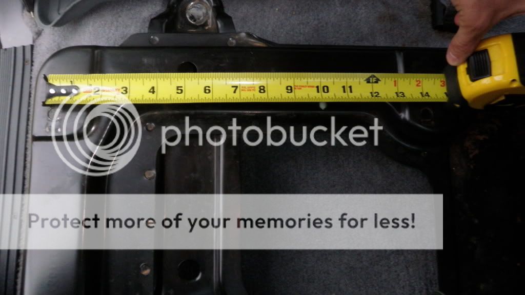

I measured the holes in the seat pan and the are spaced perfectly with the holes of the front and rear most rivets on the tracks. The tracks are little narrower, but a file will make up the difference in width.

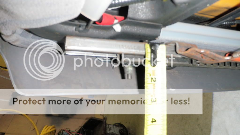

The factory manual slider is only 1" tall. So far I stand to gain 1.5" of height.

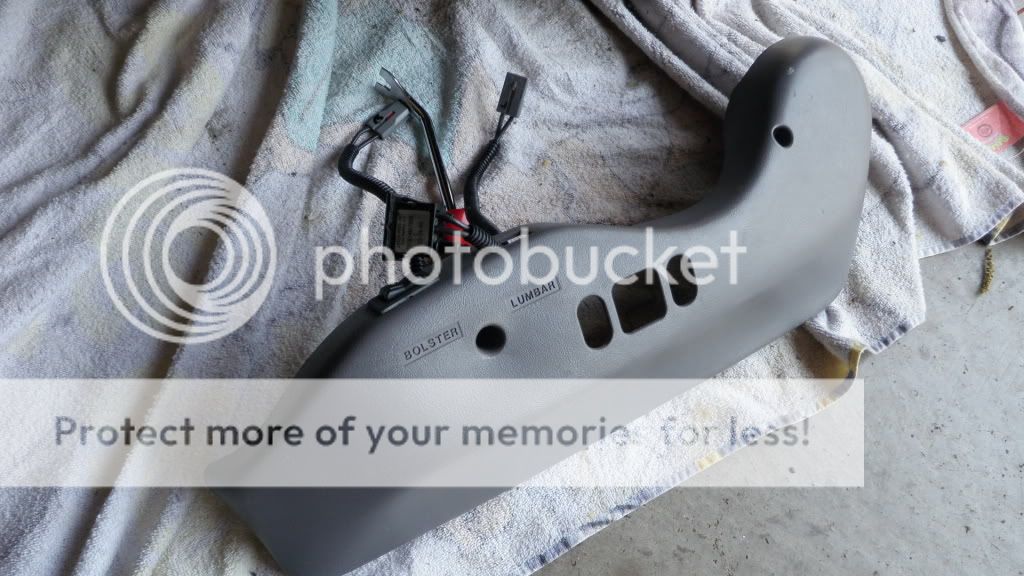

All bolted down and plugged in. *NOTE I used the factory lumbar plug to power the seats. The plugs match up perfectly. So I had to do ZERO wiring.* The seat works great. I basically repeated the process for the passenger side. Here's some finished shots.
On the drivers side there are two switches. They both trigger the motor but only the switch marked for lumbar actually airs up the lumbar bag. The front switch is a dummy for now. And you'll also notice the front switch is an older style switch. I later swapped that front switch out with another newer style switch to match.
