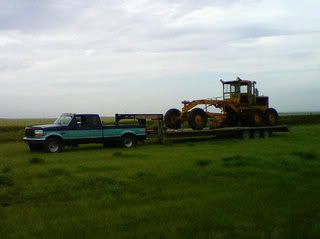

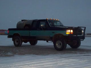

pulled the valve covers and fired her up, she runs much smother without all that crank case pressure. The smoke and blow by comes up the push rod journals on both banks. With the Pass cover off you can hear the woosh of the bad cyl. Waiting on the Comp tester i ordered for exact results. But its not looking good. Never rebuilt a diesel this should be fun.
Here are a few photos of the truck.
Picked up a 96 CRW LB 4X4-p1010796.jpg   Picked up a 96 CRW LB 4X4-p1010797.jpg
