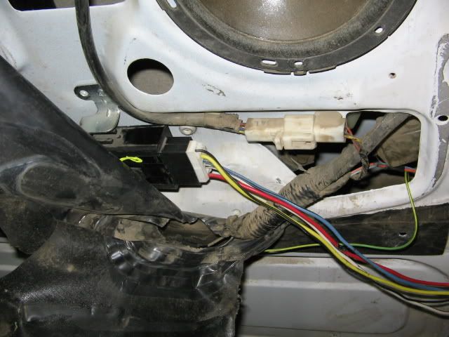

1: remove driver’s door panel.
2: mount the module

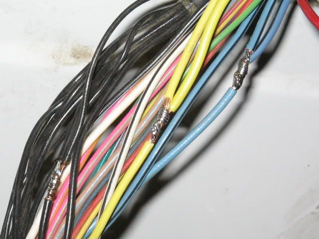

4: connect the blue/black wire of the module to either of the blue/black wires
connect the black wire of the module to any of the black wires
connect the yellow wire of the module to the yellow wire

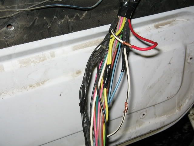

5: cut the white/black wire in the harness
connect the white/black wire of the module to the white/black wire FROM THE SWITCH.
Connect the red wire of the module to the white/black wire TO THE MOTOR

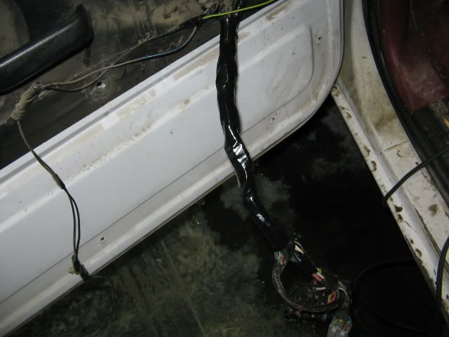

6: tape up the harness
7: test operation and replace door panel
