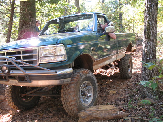

F150 with H2 wheels. Dana 60.

looks sweet! do you know how wide the rims are?
