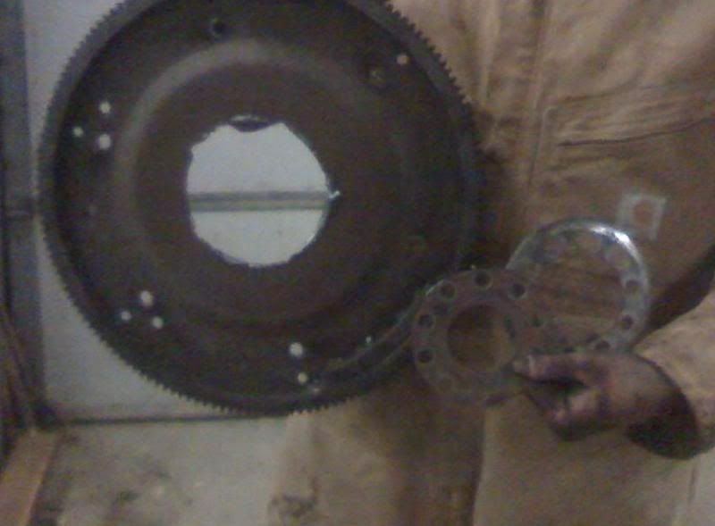

Originally Posted by symbols View Post
You may have a broken flex plate but that usually doesn't happen unless your up there in HP....
This is a broken flex plate.
Old 01-22-2009, 11:20 AM
Location: Pasadena, TX
Posts: 6,514
ummmm....yep....that one is definitely broken
Old 01-23-2009, 01:21 PM
Join Date: Sep 2006
Location: middle of nowhere
Posts: 1,095
Yup! makes a loud noise when that happens
