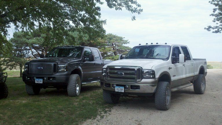

I would buy some wider wheels, 20x10s is the look I go for. The truck on the left is a 20x9 plus 10 offset and the other truck is 20x10 -19. both have 20/12.5r20s.

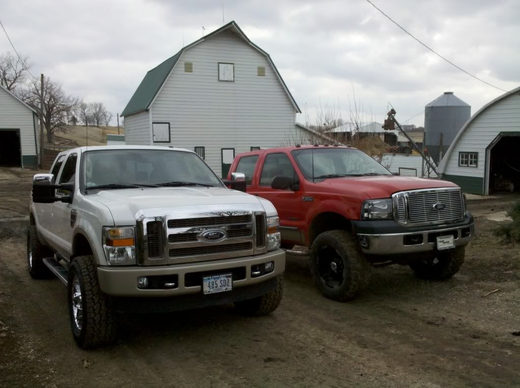

Heres my dads truck with 20x10 -12 offset wheels with 35s and a leveling kit.

Yeah you need new rims. You want a negative offset to get them outside the fender. 0 offset will be about half to an inch outside the fender, -12 will be about 2" outside the fender, and -24 will be about 3" or so outside the fender.
