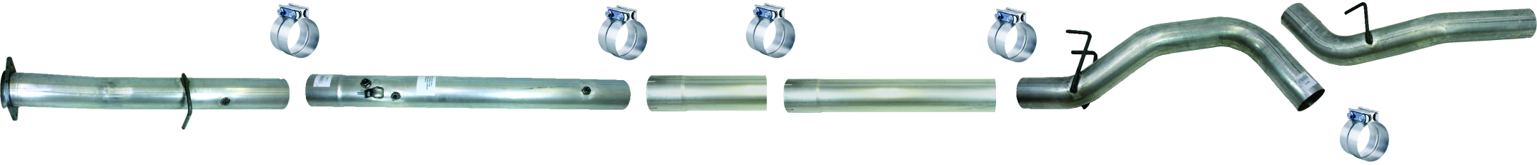

What does the flo pro exhaust look like with and without bungs? Any one have pictures?
Old 12-06-2010, 01:47 PM
Posts: 2,309
They dont have the greatest pics, unfortunately. You can see the bungs on the first two pipes.
http://www.flopro.com/parts/images/833.jpg
Old 12-06-2010, 02:06 PM
Join Date: May 2009
Location: California
Posts: 31
So would they all not be there if you got the exhaust without the bungs?
Old 12-06-2010, 02:14 PM
Posts: 2,309
No, they would not be there.
