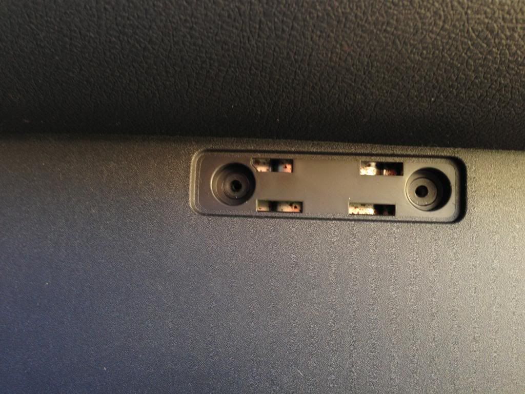

For those of you who may be considering the Jimmi Jammer door plates, I took a few pics when installing my front door plates last week. I ordered the rear door plates for my front door because I replaced my front door handle with a rear door handle, this eliminating my key lock cylinder. So to get in my truck my only options are the keypad or the alarm remote/keyless entry. I have a Viper alarm installed so if for some reason I locked my keys inside I can unlock the truck from my phone. The parts can be ordered at Vehicle Security and Theft Prevention Devices
Take off this cap on the center of the door and remove the two screws.

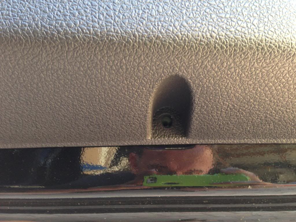

Remove this screw on the bottom of the door
And this one...

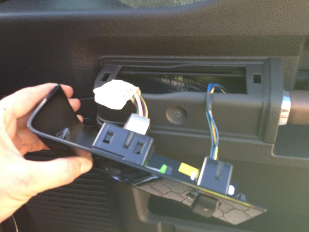

Pull up on the lock/window switch cover and remove the plugs from the back of the cover
Remove this cover from the top innermost edge of the door cover. It is held in place by two metal clips as shown, just comes off with a slight tug.

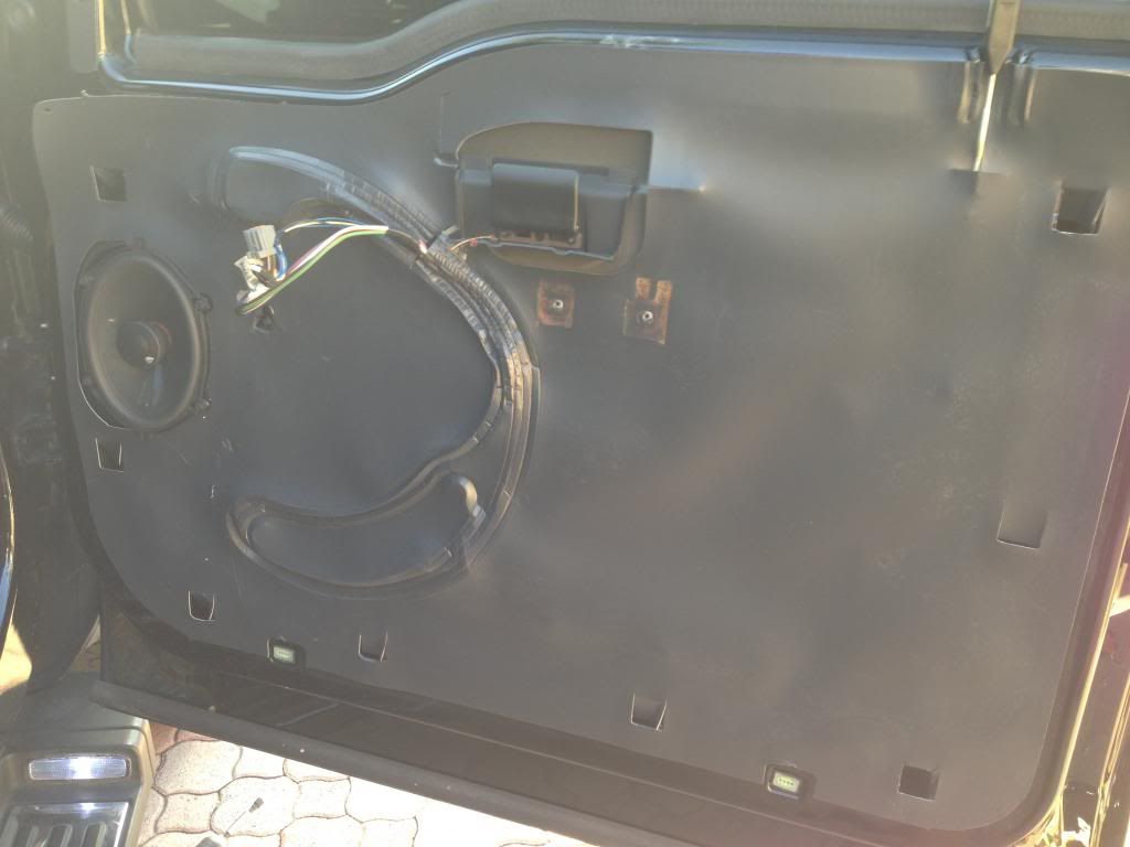

Grab the plastic door cover by the handle and the bottom and pull up, it will come off. Set it aside and this is what you should see.
Here is a pic of the JimmiJammer door plate, top view

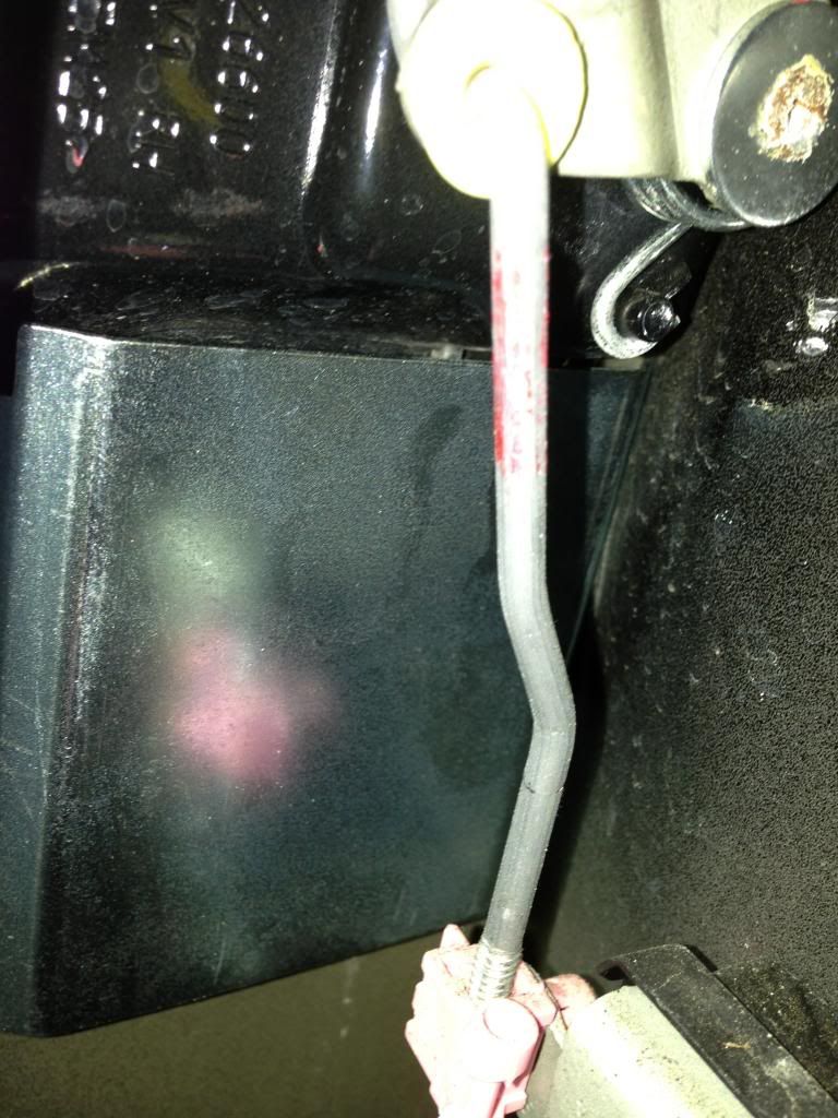

Carefully slit the plastic seal behind the door lock rod so you can peel it back while leaving the rod in place. Peel it about halfway to give you access to the inside of the door

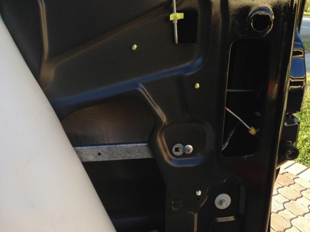

Using a few four letter words and a pair of pliers, loosen the nut you see that holds the door handle in place. Once it's loose, remove it and install the JimmiJammer door plate. Tighten the nut again. Use a few more four letter words.
Finished product
Once that's done, put everything back together and reconnect the door lock/window plugs and put the screws back in. You're done! Only 3 more doors to go.
