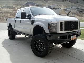

It depends on wheel offset and tire width. I ran my 38x15.50 Toyo MTs and my KMC Monsters for a few days with my 6" Fabtech before putting my 8" on. They fit and I could drive around but I would have never taken it offroad and I had to be careful because I'm sure if I would have hit a bump hard with the tires turned I would have jacked up my fender.

i have 8.5 inches of lift. with 38x15.50 and i still cant cut the wheel alll the way. and i jacked my fenders up from hitting a bump with the wheel cut.
i would go with a 36x14.50 or 15.50 instead of a tall skinny 37x12.5 or 13.5
I dont like tha wagon wheel look imo

yeah its -44mm wheel offset. 12 in wide rim. 15.50 inch tire.
they prob wouldnt rub if it was a 13.50 inch wide tire. with less offset

Matty, is your truck an '08? Just curious because the '08 has a bigger fender cut out so if you have the older body style I can see that happening. With an 8" on 38x15.50's I don't rub at all.
