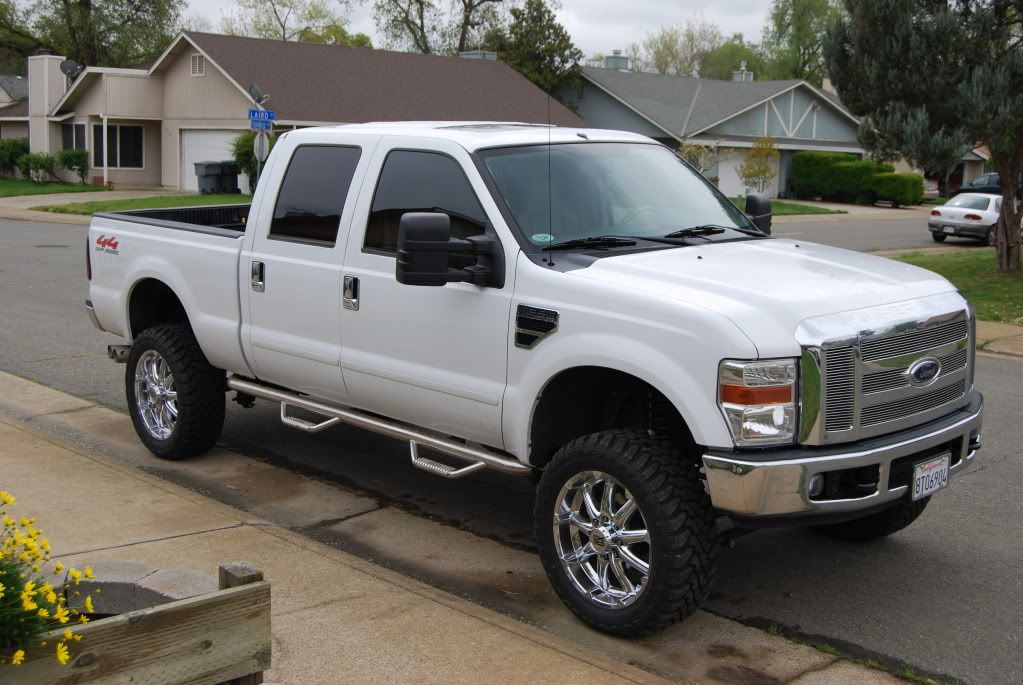

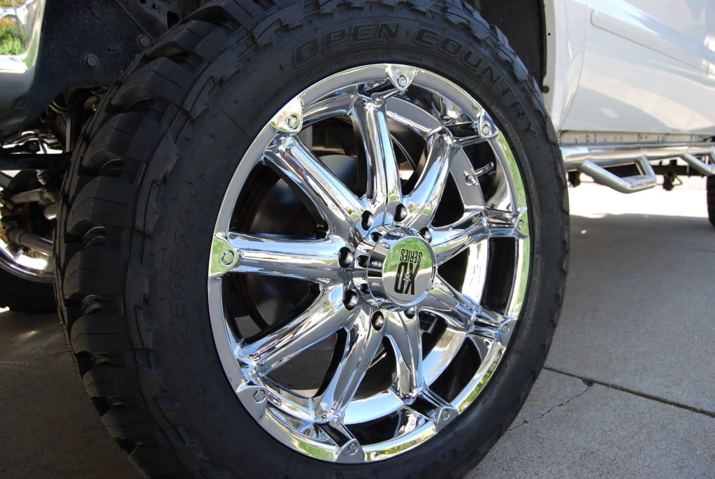

With 22's most guys are going with 37" or 35" tires. Here's some 22's with 35" toyo's
