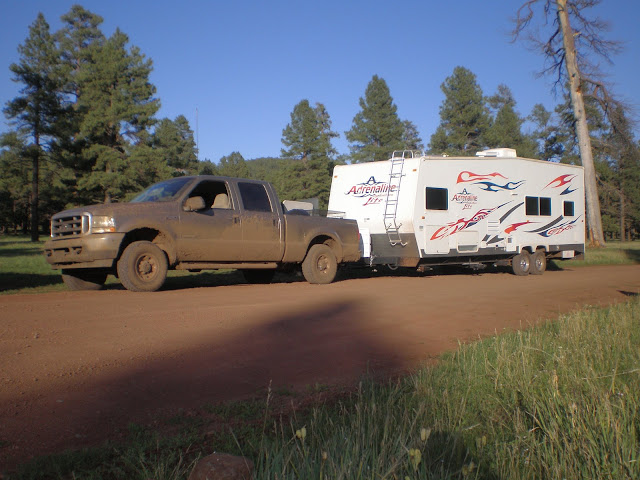

I'm hoping you can help me out here. I've read A LOT of posts here and I cannot believe the talent! I found one post similar to this but no responses so I decided to start my own thread. I have a 2004 F250 with about 84k miles; Seems there is a fuel leak as I am getting contaminated engine oil. My question is; what is the best way to pinpoint the leak? Are there common leak areas such as injector o-rings? Is that the only internal place fuel can leak from? Do the fuel lines seal to the heads in an internal or external location? I've never tore into a diesel motor before but have moderate experience w/ head gaskets, valve work etc on gassers. Is this something that could be done in one weekend?
Here's a picture of my rig:
