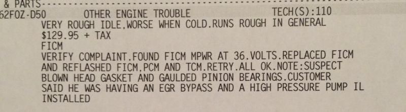

In December my father bought me my 6.0L as a Christmas present (stock). It was going to be a few weeks before I could come home to get so knowing the little information I knew about 6.0's I sent him an EGR delete and an Oil Cooler to get installed. He also took it to a Ford dealership to get looked at. My dad told me that the dealership was super impressed by the truck and that it ran great, that there was no problems found. Well....i stumbled upon this a little while ago. The report from the initial inspection.
I was under the impression that this was a good running 6.0L, as my dad told me there was no problems and it passed with a clean bill of health. My dad apparently didn't tell me the whole story . I came home to pick it up and it DID run great. I was beyond happy. No white smoke, no hard start, ran smooth, etc. The only thing I noticed that it blew cold air at idle, it wouldnt warm up until i hit 1,500 RPMs. Once I went under 1,500 RPMs it would blow cold again.
