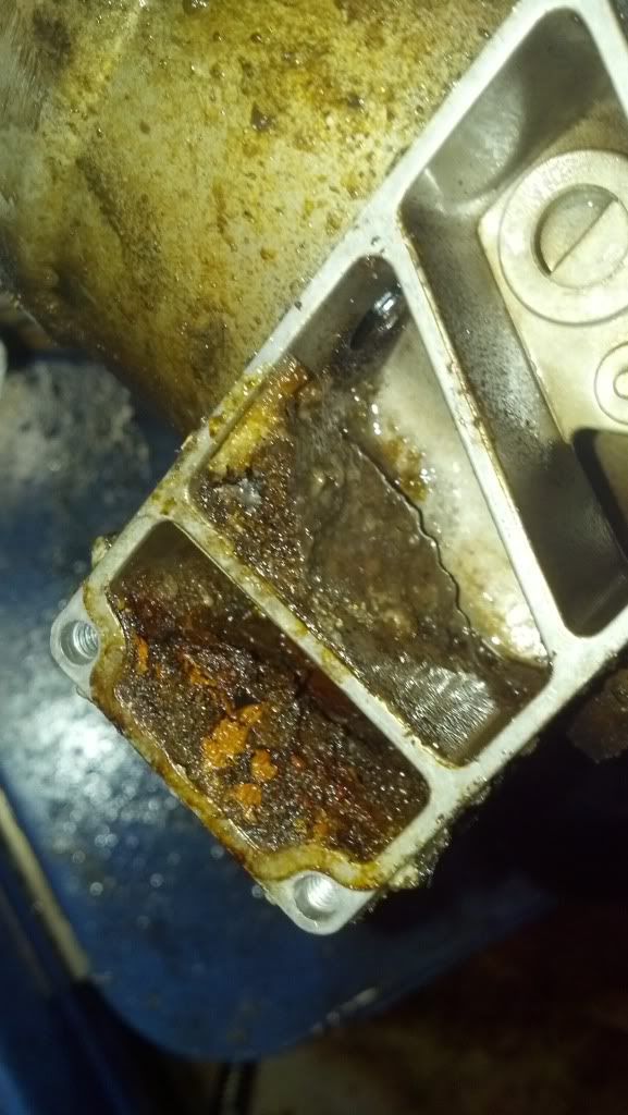

Have you drained your HFCM lately? Do you have a blue spring kit installed? I just went through the same thing as you. Changed my filters and drained my HFCM regularly. Each time I changed my filters there was always a little debris in the housing, so I just cleaned it out. Nothing but diesel came out when I opened the drain. Then I started having issues with psi, so I decided to pull the pump apart.
[IMG][/IMG]
^^^ this was packed behind the front cover and it was solid and hard. I dug it out and pulled the pump itself which was discolored from starvation. Long story short put it back together after cleaning and the pump wouldn't prime to save it's life. It chit the bed right in my driveway. So.... that being said, check the filters, spring, etc first. And if that doesn't do it check the pump.
Yeah, but not everyone makes french fries in their truck!
You more than likely have to replace the pump, and yes, it may be a good idea to take it off and crack it open. However, you could just change the pump in the truck.
