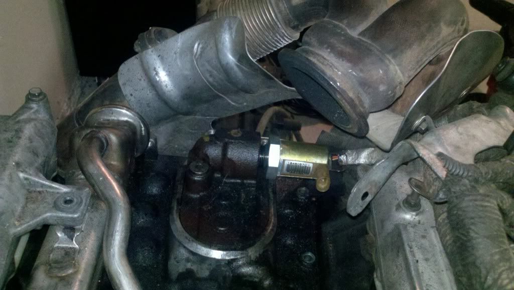

Is the IPR screen the screen that is under the oil cooler or is it in the back in front of the ICP sensor? I replaced the screen under the oil cooler because the old one was definitely broke.

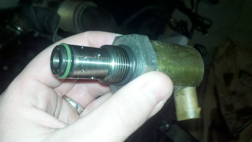

The screen goes on the TIP of the IPR...Notice how mine was missing (original spare engine)
I remember seeing the buldge on the drivers side of the cover and thinking to my self, i wonder whats it there... Thats going to be a last resort because those dang up pipes are no fun to take loose.
