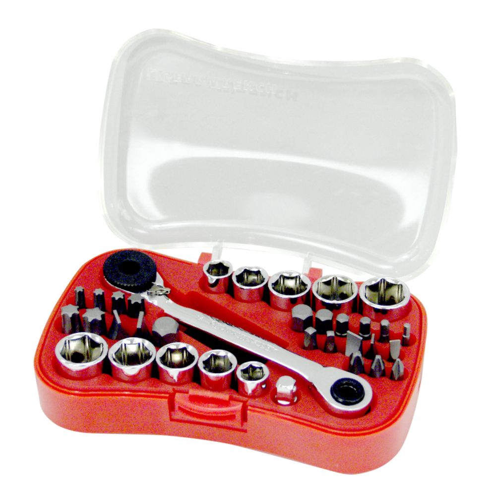

use these two tools and you will thank me, I can have the passenger side down to injectors in a half hour.
12mm flexhead ratchet wrench
and this think is a fricken life saver on oil rail bolts, gearwrench bit ratchet set.

i have a gear ratchet set and it makes life alot easier.. no worries about deep sockets and things fitting in small places

I ended up using the stubby version of this for the lower aft bolts on that valve cover. Racheting wrenches are a lifesaver sometimes.

^ where do you get this brand name wrench set?

you can get the gearwrench set and ratchet wrenches at sears, thats where I got my stuff from.
