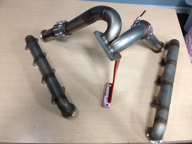

i highly suggest you check out MPD's new kit, comes with a completely custom built y pipe with a turbo flange welded on so no need for an adapter and its built as a dual volute so you can get the most out of a divided housing, will com with everything to mount an s300 turbo
Did they just come out with this? it sounds like a great kit.
To the OP, most kits for the 6.0 come with an inlet adapter, so the OEM y-pipe is used. The powermax is going to be the cheapest option, but there is a lot more potential for a nonVGT.
