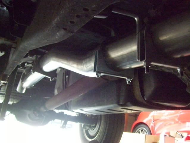

let me know if ya have any more questions, heres pics of the install
4" connecting to turbo looking ridiculously huge
bottom of down pipe, tight fit all around
Connecting mid pipe to down pipe
Tranny crossmember clearance
axle clearance
connect the two sections, this is where i had to cut piping because i have a reg cab, long bed. but even if you didnt have a reg cab still do the exhaust in two sections then connect them
finished
here is what it looks like now, moved the tip away from the body
*** these u bolt clamps are tough, 1. really easy to over tight 2. crush pipes and they will never seal good 3. take patience
the clamps are tricky and take time to get them to seal but thank god for diesel soot because it makes it easy to find where your leaking, then ya just play around with the clamp to get them to seal. these are the clamps all most all kits come with because the band clamps are expensive
