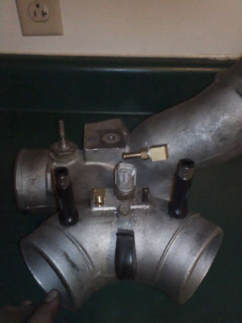

Ok this is where I put the 2 nozzles

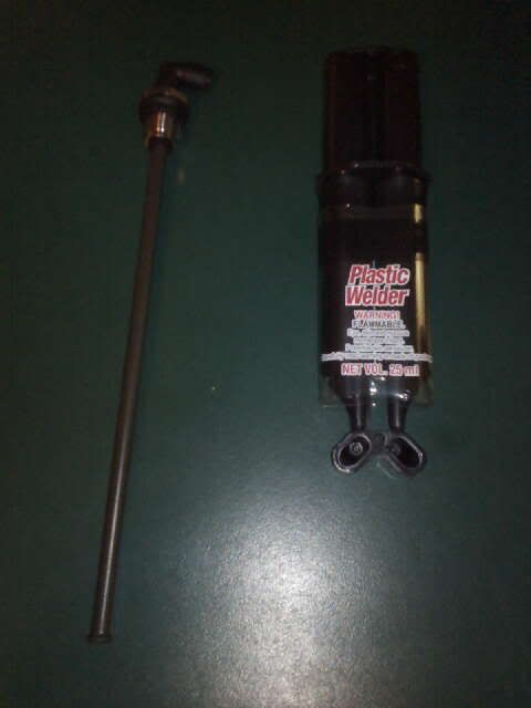

I used the winshield washer bottle as my tank. If it looks like it was a pain to get the pump down there, then your right
I used a piece of brake line as a draw tube epoxy-ed into the top of the tank

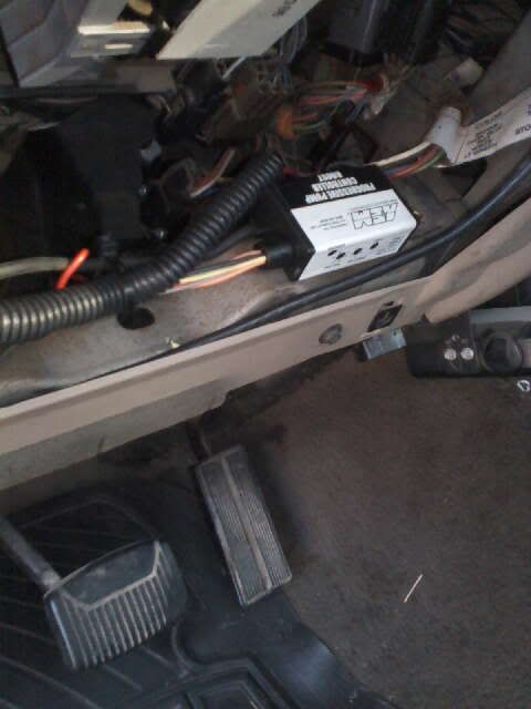

Here is where I put the controller. I have it set to start at 5 psi and be at full pressure at 25.

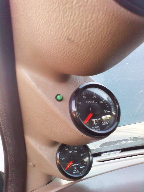

This light comes on when the system is injecting methanol. BTW I love my DiPricol gauges.

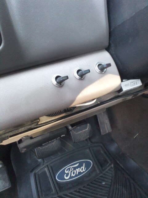

Here is where my switch is. Left one is Strobe lights, middle is Methanol, right is my EBPV. There all different colors, yellow, greeen, and red respectively
