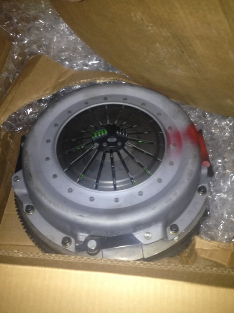

Well I currently have like 400 miles on my valair ceramic dual disc so far so good not to grabby and drives pretty nice it's quiet too. Thing weighed like 125 pounds.
Only pic I got.
Sent from AutoGuide.com App
