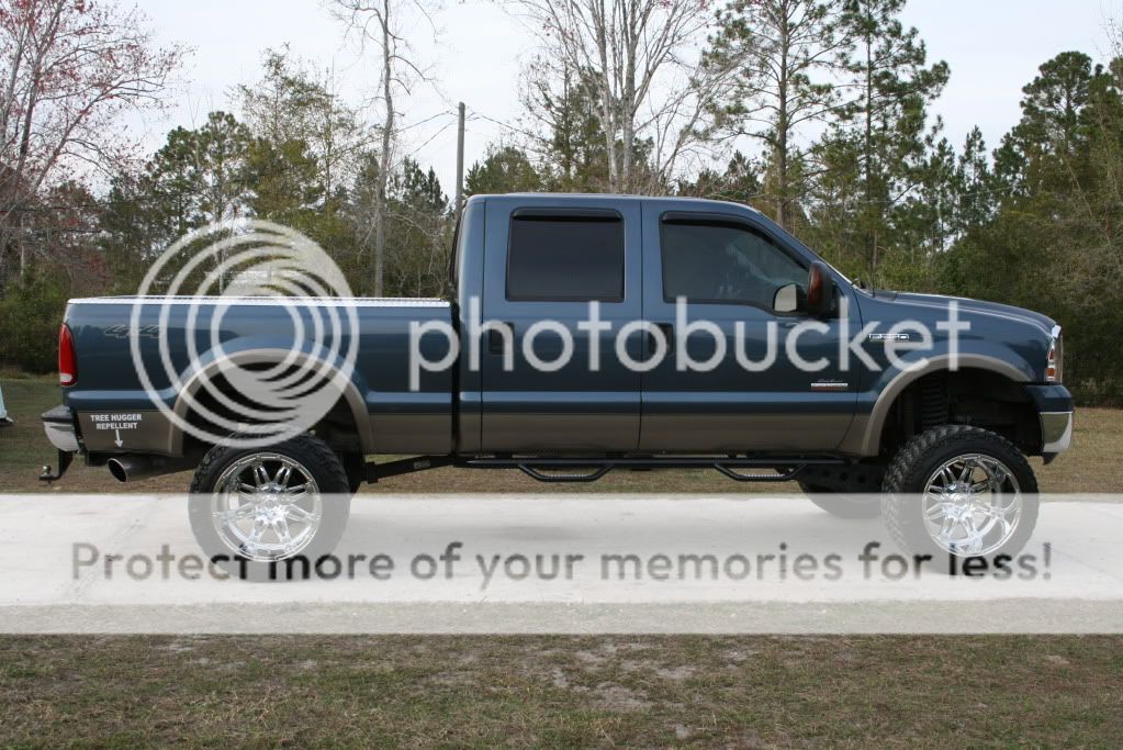

I used PHP to flash my FICM and my PCM. Using Matt's SRL tune I get 19MPG's on the highway with 35" tires. You may have some other issues. If you have injector problems you don't see now and you have your FICM reprogrammed they will show up and you will have to resolve those issues. I'm no diesel mechanic but, I did stay at a Holiday Inn once. I also live in Florida, pretty flat highways around here.
