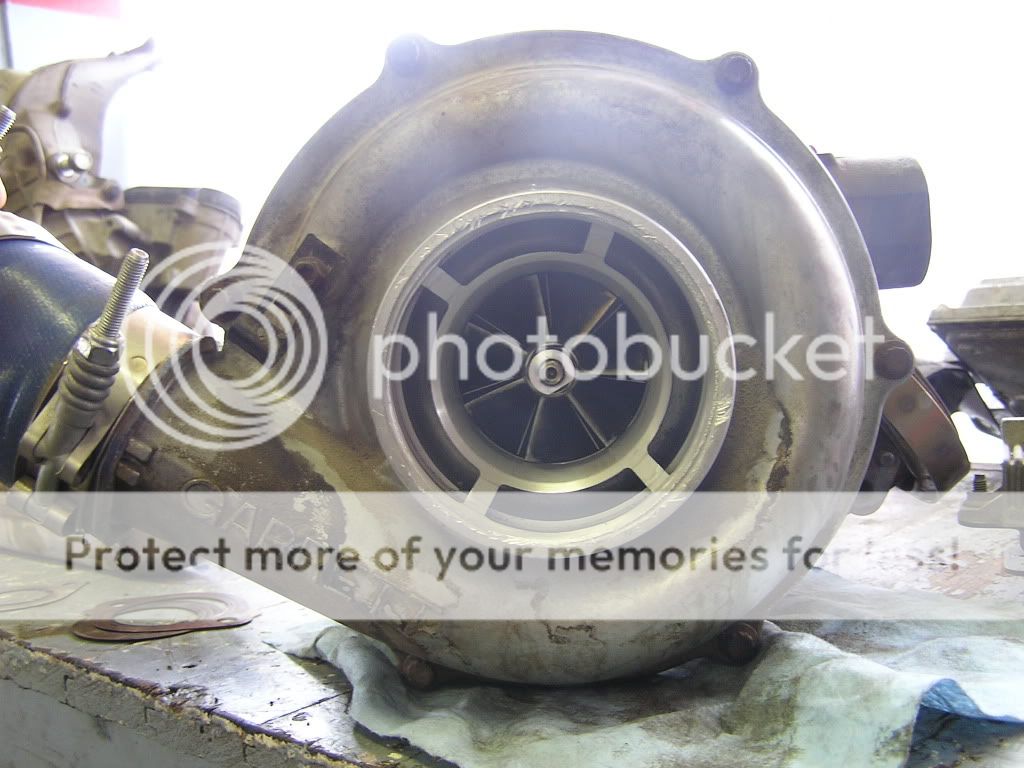

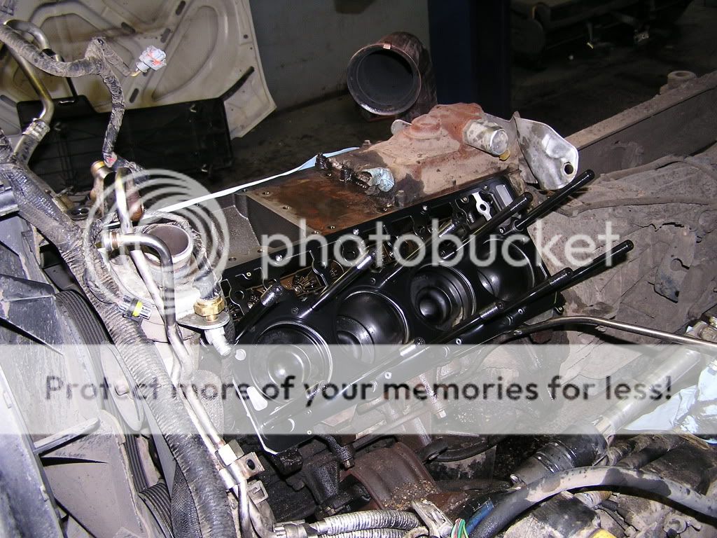

Turbo and intake manifold off.

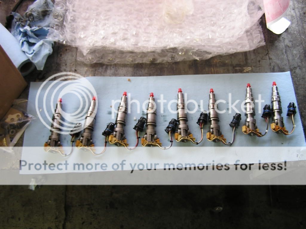

Old injectors.

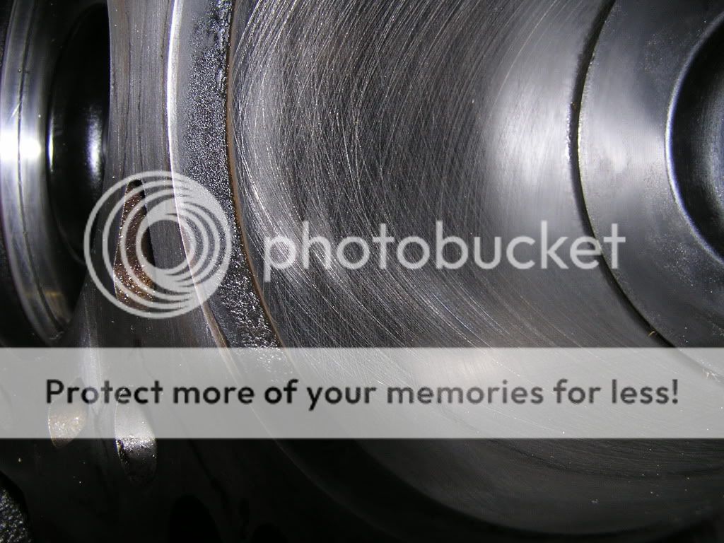

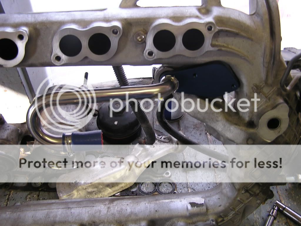

EGR delete.
CCA delete.(two washers,a bolt, silicon and two nuts.)
Silencer ring removed with 3" hole saw and buffing wheel.
