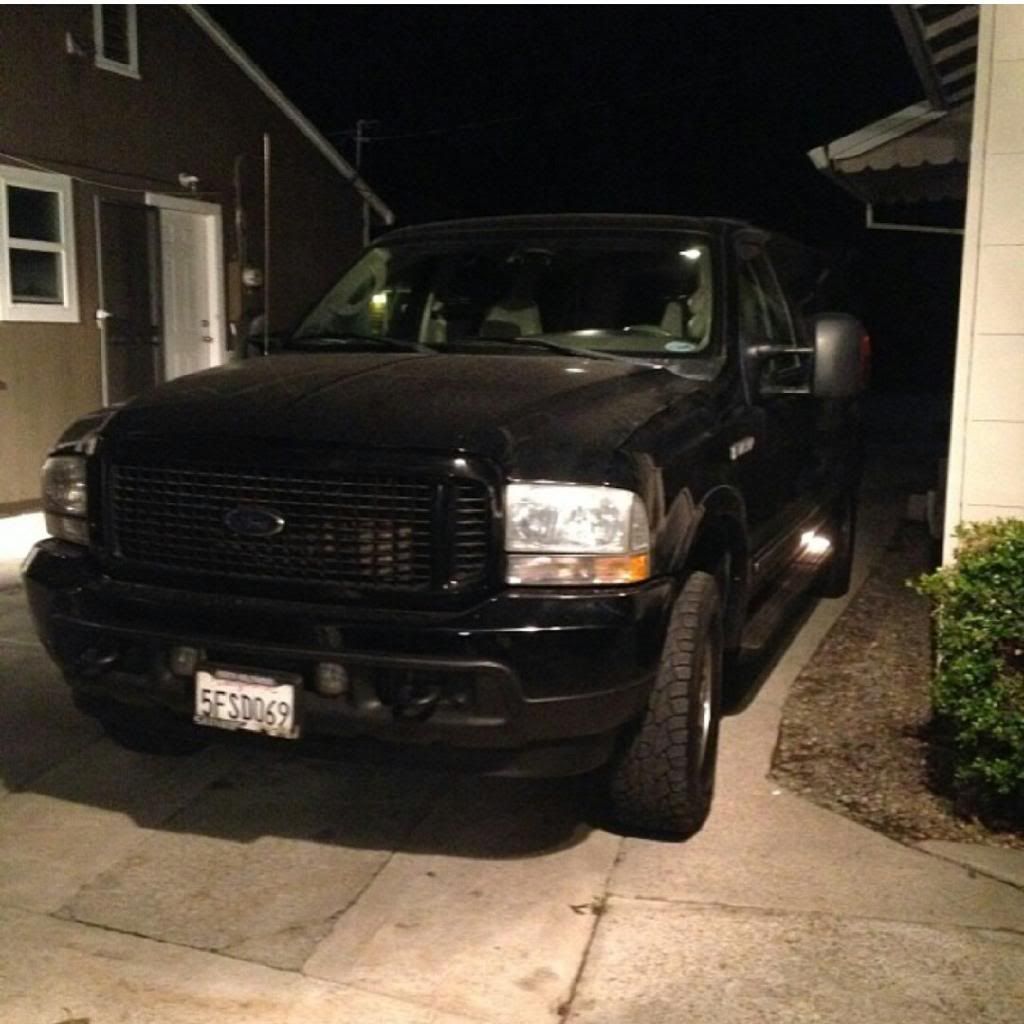

So I had a kid, my first, and decided we needed a bigger family-mobile. We used to have a tahoe. Anyways starting with an 04 6.0 Excursion limited, Ill make a short list of the mods I plan on doing myself, and having done. My family and I will use this to tow a 27' toy hauler. Ill try to post pics as stuff happens.
Exterior - 05+ harley headlights, grille, bumper, 08+ mirrors and rear bumper, bumpers and grille painted to match body, randy ellis designs light bar mount, 40" led on the front bumper, at least 1 50" led light bar on the roof
Interior - JVC double din N510HDT, havent decided on speakers, and I probably wont be doing amps, or subs
Wheels and tires - American Force 22x12 burnouts, 325/50r22 Nitto trail graplers
Under the hood - studs, pmm egr delete, oem oil cooler, powermax turbo, 4" MBRP exhaust, Bullet Proof FICM and water pump, AFE inatake, homemade CCV, ATS trans, SCT livewire with innovative tunes
Suspension - heres the fun stuff... 05 axles, custom 4 link up front, king 2.5 coilovers, possibly bypass's, rear gets fabtech springs and 2.5 king resi shocks, front and rear 4.30 gears and a detriot tru-trac in the rear.
Heres a pic with what I picked up! Ill post most as the project gets moving. The front end is already at paint, and some of the lift is being cut and welded as i type.
