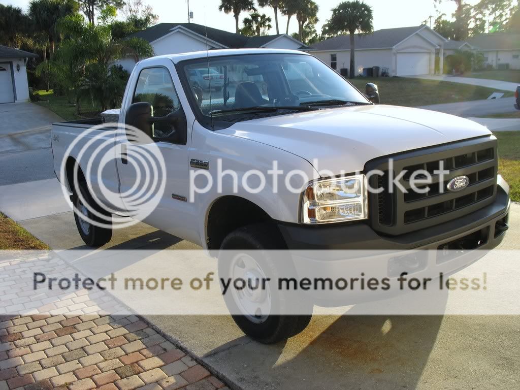

Yep I’ve been busy this last month.
I was looking around on eBay and came across a cruise control kit for 05-07 superdutys. It was 150 bucks so I jumped on it!
The install was pretty straight forward.
Ford part number 5C3Z-9A818-AAA
Now on to the good stuff. I purchased some 35x12.5x17 bfgoodrich mud terrain km2 tires. Had them mounted to the stock XL wheels (hey I’m cheap and I love the 0 maintenance these wheels require) I may upgrade to black rock crawlers - I’m undecided. Anyway I also got a 2.5" leveling kit installed. I think it turned out great.
Before
After
I found a nice deal on some 08 tails so I grabbed em. I however was not aware that this was not a plug and play mod. . SO after some research I found that a few venders make some wiring kits to make it plug and play. I didn’t agree with the price (I’m cheap, as mentioned earlier) so I made a trip to the junkyard in search of some options. Upon my arrival I came across a 2004 lincolin LS... Bingo, just what I needed. 3 bucks later I was on my way home.
So, all in all it ended up costing me a little time to run to the junkyard, but well worth it imo. Plus I saved a lot of money (no, not by switching geico).
Also here is a previous thread - 08 center console and bucket seats.
CLICKY
Enjoy!
Any questions please ask away!
Thanks for looking

Looks great. Love the tires and tail lights. Now you just need is the tailgate

looks great!!...are the 08 tail lights an exact fit?,,I have an 05 and they would look great..

^yes they bolt right in but the reverse light harness is different though
What seller did you get the cruise control kit from? I want to do that to my work truck. What else do I need besides the steering wheel?

I purchased from partsintl on ebay. Theres a few pieces you need, its all in that kit. Ford part number 5C3Z-9A818-AAA

What kind of leveling kit did you use?

Wish mine as a newer body style. I had to go up anouther 2" to clear the 35's.

Readylift.
