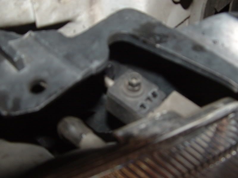

its a little rod / screw behind head light not the higher screw but the lower one behind the head light is the one you want. i suggest doing it at night on a long road. so you can see how far you are moving it.
this screw moves head light side to side
this one moves up and down crappy pic sorry but youll prolly find it.
