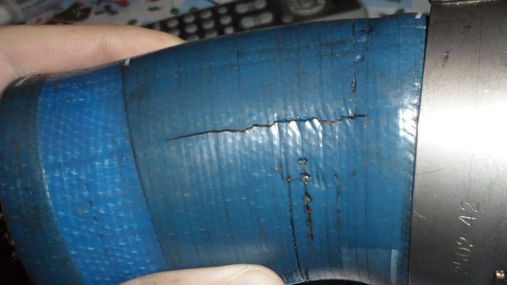

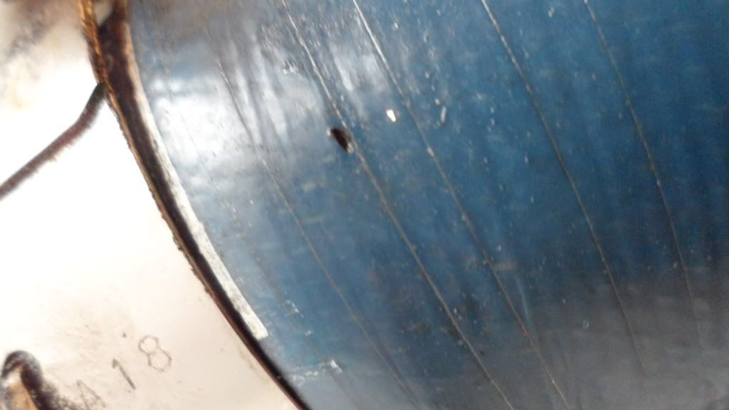

I took the hot side boost rube off with the boots and i found this:
My Solution:
I'll test soon to see if it worked and if that was the problem.. I'm REALLY thinking it was so.. fingers crossed!

Don't feel too bad about having a hard time finding that one, I had one go under the wires at the other end. On my 07 I will probably be replacing the same boot as you soon. It hasn't let go yet, but it is starting to look a bit rough.
Too bad about the intake bolt. As long as the gasket is in place you might be OK. Only time will tell. Don't over torque those bolts.
