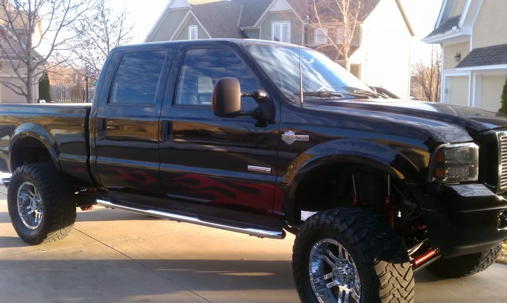

See truck in sig

no real answer to the question , i just wanted to say SWEET TRUCK !
