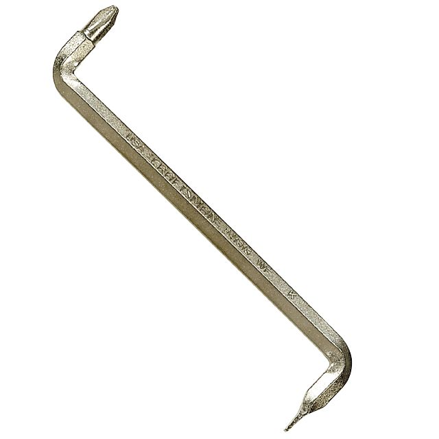

Also, on other threads there are a lot of ideas on pulling the glow plug harness out. I have a little craftsman right angle screwdriver for tight places
that I was able to hook into the slot where the super-expensive-for-what-it-is ford tool goes and pull the harness out. Just another idea . . .
