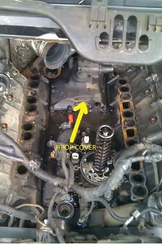

Okay Fellow PSD owners heres my situation, I blew my egr cooler and i have already gotten my new egr delete kit in but before i put that in i want to fix a oil leak i have. I believe its coming from my HPOP cover.... is there a gasket located under it? i called the local ford dealer in town and they are just plain stupid and couldnt find it on there screen does anybody know the part number or would it be easier to just replace the cover itself???

when i did my STC fitting I cleaned it good and put a little rtv back on it. mine doesn't leak. I think I have the gasket in a bag at home, i'll see if i can find the part # for ya.
BTW, when you do go to pry it up, be carefull, its a sharp little bi@tch! blood sacrifice on that one......
