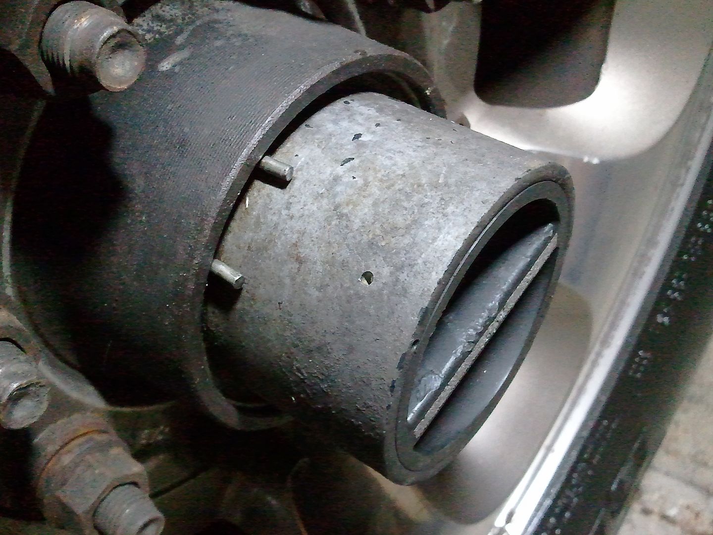

My early '04 auto locking hubs were froze up. I could barely turn one with pliers. I had nothing to lose so I drilled a 1/8" hole in the edge of the hub to try to flush out anything that might make the selector knob freeze up and to get as much lubricant in that area as possible.
In this pic you can see where the hole was drilled.

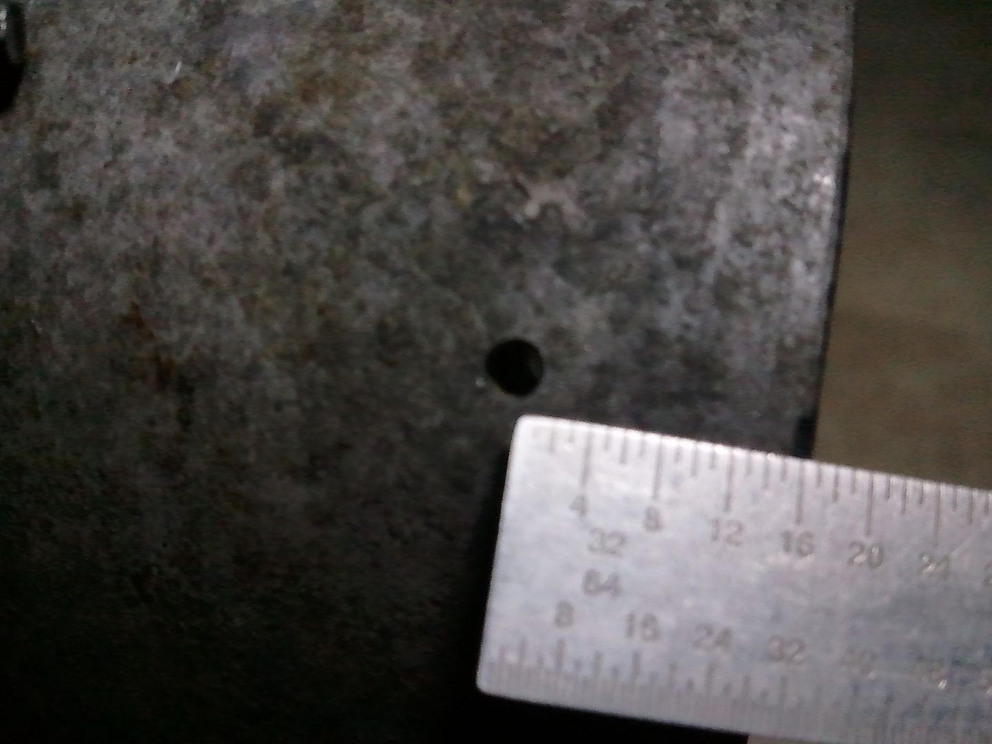

There is a rubber diaphram that you must not drill into or in front of, otherwise the hubs won't hold vacuum. I just measured inside the hub down to the diaphram, and referenced that to the outside of the hub,landing the hole behind the diaphram and in front of the selector knob. The measurement from the edge of the hub was 1/2".
